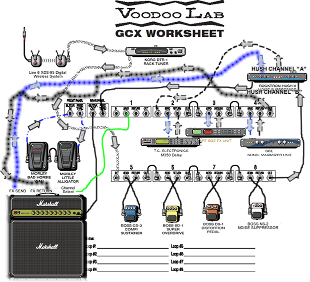

JohnClark wrote:I see two things that are likely just errors on the drawing as they would cause there to likely be no sound and prevent amp channel switching.
-The Line Level output (black dashed line) of the Hush should run to the In of GCX Loop 2 in order to feed the front end of your effects loop effects chain.
-The Channel Select (green line) should be connected to either the Send(N.C.) or the Out(N.O.) of GCX Loop 1.
Some of your questions require quite involved answers as general explanation, so how about we first try to solve the rig problems and I will try to explain why they occurred in your setup as we find them?
Is there any difference if you run the output of the Bad Horsie directly to the instrument input of the amplifier?
I hope that helps!
John - you are correct on your first two points - they are both errors in my drawing - that "OUT" from the Hush goes to the "IN" of Loop 2 and the channel select is actually connected to Loop 1's "SEND".
To your question, I don't know, I'll give that a shot as soon as I get home. Now that I look at it, that makes sense. Aside from the additional distance the signal would have to travel, is there any other reason why making that switch would have an impact? (not questioning you - just trying to learn :D )
thanks!

GCX Signal Path Help | Buzz Hum and Tone Suck
OK, so I had my rig set to what I thought was OK :? , then I tried it out live and by mid-second set, everything just seemed like crap :evil: ... After we were done, I discussed a bunch of things with my keyboard player who is also familiar with racks and running sound - things like compression, ground loops (which I think I'm still a little fuzzy on), poweramp vs. preamps, yadda yadda... some of this stuff I knew, some I didn't. The one thing he did help me get comfortable over was that regardless, it was just gonna take time fiddlin' with knobs till things sounded right (I have no problem with troubleshooting or trial and error, but spending my time fiddlin' with knobs when there may be some other more fundamental problem that needs to be solved first, is something I find very frustrating). Which leads me to my post...
After that night I've spent a bunch of time trying different electrical configurations (for the ground loop issue), rearranging my rack, upgrading cables, etc, etc... I think I'm in a good place now, but I've not yet tried this out with the rest of the band playing (i.e., cranked at stage volume), so I'm not sure exactly what to expect in the way of feedback, hum, buzz, grounding issues, etc...
I've attached a worksheet of my setup as it stands (when you see it note that the Hush is in front of the poweramp AND at the end of the FX loop - the NS-2 is used as a mute switch). And for what it's worth, the Marshall is an AVT50 (not the JCM900 as it appears in the pic).
Please take a look and let me know if you see anything that is obviously wrong. Or if you see any potential issues. Or if you think there's a better way to run these pieces.
UPDATED GRAPHIC (FIXED TWO CONNECTION ERROS IN DRAWING)
Also (for someone with no real electrical background, who is new to the concept), how do you tell the difference between ground loop buzz/hum vs. buzz/hum/feedback because you're playing distorted and loud?
When using noise suppressors how do you "find the line" between killing the hum but not killing your tone/level?
Thanks!
Tom

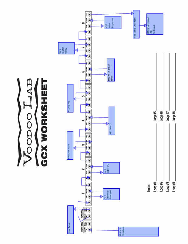

Okay - based on your suggestions, this is what I'm thinking... Let me know if it makes sense to you.

JohnClark wrote:If you have an effects loop, you should at least try out the two different routings. The processors are all candidates for running in the effects loop. I hope that helps!
I presume you mean using the effects loop of the Amp Head?
Are you suggesting (when using the head) running the entire chain through the effects loop, or only a portion of the chain described above?

I'm in the process of reconfiguring my rack. I'm trying to get as much versatility out of what I have, as I record and play in two very different bands (one rock/metal and the other blues/funk/R&B, etc).
I have attached a CGX worksheet with what I'm thinking... I'm hoping to pull out anything from acoustic to metal to funk all on the fly, ultimately going into either 1) in front of a Marshall 50W head OR direct to PA (depending on which band I pay in.
The main reason for the multiple effects processors is 1) there are tones in each I really love and 2) if one craps out, there's always a back-up (of sorts)
If anyone has any comments about going in front of the head, I'd love to hear them (I'd hate to get some great stuff outta the rack only to have it sound like ass passing through the head).
Not planning on anything fancy here (no w/d/w, stereo - for now), just versatility...
thanks for any input!!!
Tom
